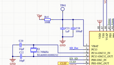

2025-12-10 5:59 AM - edited 2025-12-10 6:04 AM
Hi again,
Here is my connection diagram :
Vbat is around 3,5V normally. It is not charged by the µC but by a dedicated circuit. I also deactivated the measure on Vbat since the measuring error is about 10%.

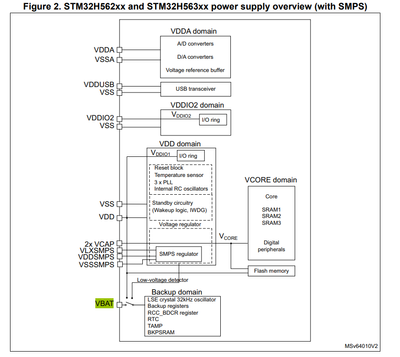

2025-12-12 8:13 AM
hello @Karakala
If you review the diagram in the datasheet, you will find out that the backup domain contains RTC and other peripherals.
Honestly, this is not a commonly known issue because The RTC is supposed to be functional in VBAT mode and in all low-power modes when it is clocked by the LSE. however, can you verify the selected LSE driving capability option is compatible with your gain margin? you can use AN2867 to calculate it.
You can refer to this thread also.
Hope that helps as a start

2025-12-15 1:07 AM
Hi @Gyessine
Thanks for answering me. I calculated it with my quartz parametters (ESR = 50kR typ/70kR max, C0 = 1,7pF and CL = 12,5pF), I makes gmcrit = 1,71µA/V. It means that only the High Drive Capabilty has a higher value (2,7µA/V) according to the STM32H563 datasheet. My gain margin would be inferior to 5 ?
But yet it works since my RTC is running correctly when it is powered. This could explain that it is not saved ?
