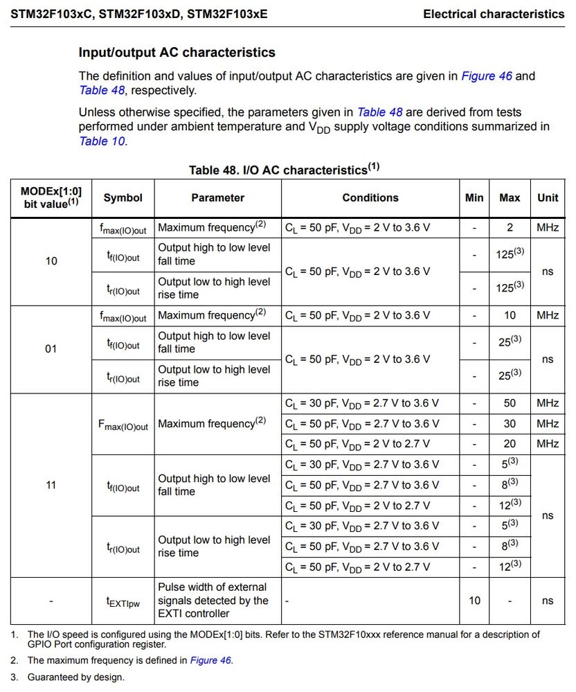

STM32F103RDT6 Data Sheet https://www.st.com/resource/en/datasheet/cd00191185.pdf
Depends on the loading, and depends on the slew rate (speed) selection on the GPIO configuration
