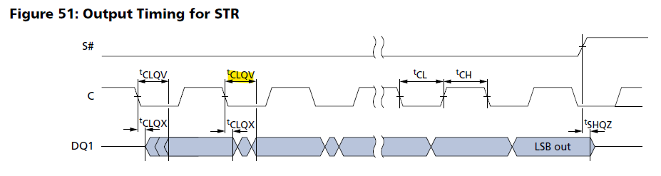

For example, the MICRON MT25QL flash, which is equipped on some ST evaluation boards e.g. STM32H750_DK and STM32H753_EVAL, puts data at falling clock to IO after 5-6ns as shown here (tCLQV).

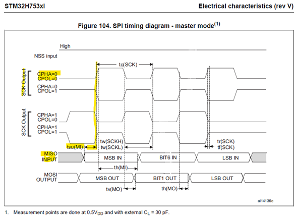

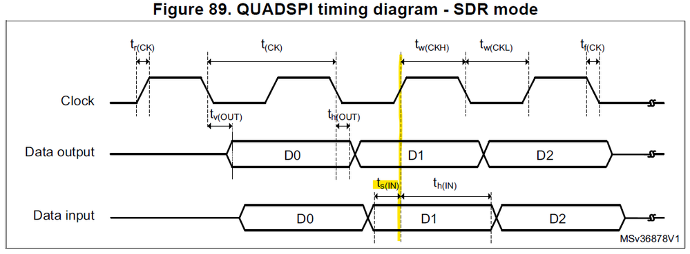

In SPI or QSPI SDR mode the H75x latches data at rising edge which must be valid at least 2ns.
Same for QSPI SDR

tCLV is between middle of clock edge and data valid.
tSIN is between when data must be valid and the middle of the next clock edge.
Rise/fall time doesn't enter in to it here, it's already baked into those constants.

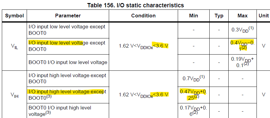

Regarding "data valid": this is IMHO related to the "IO switch voltage" of the SPI device, e.g. for H75x
IMHO the H75x "sees" low level if the input voltage goes below 0.4*3.3V-0.1V = 1.2V and high level if above 0.47*3.3V + 0.25V = 1.8V. The MICRON differs here, the device seems to be more "CMOS compliant".
So IMHO the timing constants are not constant because it depend somewhat on the voltage level of the connected device a bit.
Input levels on the STM32 chip are CMOS compliant. 1.2V/1.8V are certainly within the allowable cutoff thresholds. Is the MICRON not CMOS-compliant? That doesn't sound right.

IMHO, only considering tOV and tSU, the maximum clock frequency calculates as
tCLK/2 = tCLQV + tSU = 5ns + 2ns = 7ns -> 1/(2x7ns) = 71MHz
What is wrong in my calculation?
> the threshold values in table 156, noted as "guaranteed by design", are not exactly CMOS compliant, but the MICRON thresholds seem CMOS compliant.
In what way are they not exactly CMOS compliant? The datasheet goes into detail on how they are CMOS compliant and shows the levels vs CMOS thresholds. Thresholds of 1.2V and 1.8 V are sufficient here.

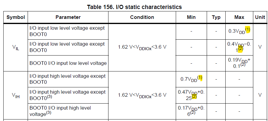

Hi @TDK
maybe I'm reading between the lines but simply telling from the notes to table 156, the H7 thresholds "Guaranteed by design", are calculated as 1.2V/1.8V at VCC=3.3V. In opposite to that, the CMOS thresholds are 1.0/2.3V, which are labeled as "Compliant with CMOS requirements".
This tells me that the H7 thresholds differ from "CMOS standard". No clue if this means that the H7 is "CMOS compliant" or not.
But this has some effect on timing calculation e.g. a rising signal at H7 input is earlier recognized as HIGH (1.8V) as in standard CMOS (2.3V). Same on falling edge. This may have a positive effect to H7 setup time in our timing calculation example because IMHO it extends the setup time at H7 read a bit.

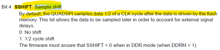

2025-10-08 11:29 PM
Regarding QSPI SDR, 100MHz are allowed, because according to RM0433 data sheet, the QSPI peripheral has a "sample shift feature" which does data sampling at the falling clock at H7 read.
