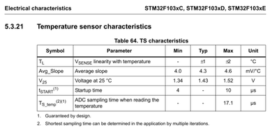

The temperature sensor characteristics:
2024-03-16 11:18 AM - edited 2024-03-16 11:19 AM
You have continuous conversions on, so the ADC is constantly running. For what you are doing, this seems like the right thing to do. Just set it to convert those 2 channels forever, and put them in a circular buffer. Read them out whichever you want. Only call HAL_ADC_Start_DMA once at the start.
> The room temperature is around 21 degree centigrade while the reading is 31.
This is consistent. The reading you are getting is the junction temperature on the chip, which will be higher than ambient as the chip is using power and heating up. A delta of 10 C is normal. Slowing down your chip so it uses less power and heats up more will reduce the difference. If you want to measure ambient temp, you will need an external sensor that stays at ambient temperature.
