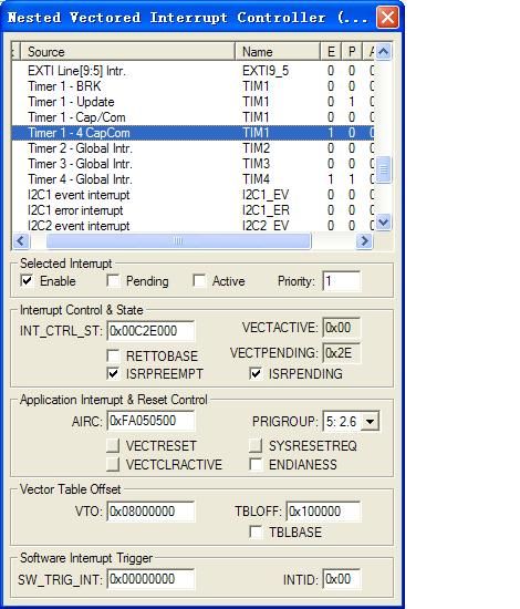

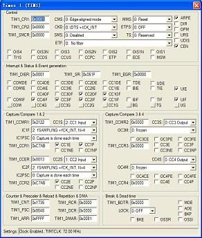

but the can not enter the TIM1 cc1 intterupt isr. i check the NVIC. the2011-09-28 10:25 AM
Observations :
TIM_TimeBaseStructure.TIM_Prescaler = 72; This needs to be 71 (ie N-1) to do what you want. ie get 1 MHz from 72 MHz RCC_APB2PeriphClockCmd(RCC_APB2Periph_TIM1||RCC_APB2Periph_GPIOA, ENABLE); You keep using '||' throughout your code, where the single '|' OR is supposed to be used.We’re moving the ST Community to a new platform to give you a better and more reliable community experience.
