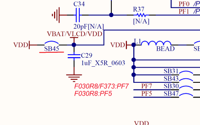

What Hardware are you using? ST board? custom board? Blue/Black pill?
2024-11-05 1:18 AM
I’m using the Nucleo F103RB board along with a CR2032 coin cell for RTC backup power. After turning off the main power, the coin cell supplies the backup power to the RTC.
Let me know if any additional details would be helpful.

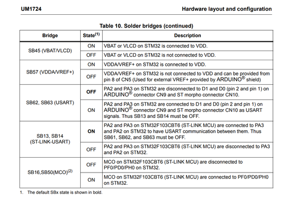

2024-11-05 1:29 AM
What about SB45 solder bridge? soldered or not?
2024-11-05 1:42 AM
Yeah,Thank you for the reminder! I’ve checked the UM1724 reference manual and have removed the SB45 solder bridge as suggested for enabling the coin cell backup.
