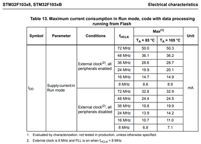

The data sheet lists power consumption characteristics. 40mA after including external LED and ADC seems in line with what it suggests, for undisclosed clock speeds quite high, for an unprogrammed part. Lower clock speeds will use less current. You can hold the chip in reset to see what the relative consumption is at idle vs with code running.

I will certainly check while holding the chip in reset to see what the relative consumption is. However, it still seems to me that current consumption is high. I was actually wrong. This is DC/DC Buck converter and efficiency is about 85% at light load. So output current of the buck converter is actually higher than that I see on the bench power supply (40mA)... (5V * 40mA * 85%)/3.3V = 51.5mA. It still seems too high.. is this reasonable amount of current consumption? Current consumption of LED and ADC is pretty low according to the datasheet. Again, I will check after configuring the chip with some code but the current consumption seems to be still too high. What would be the best way to validate your PCB is okay without programming the chip? Is there any app notes that explains about the chip's default state and current consumption? Otherwise, it's hard to validate the PCB design.

Hi, I think I solved the problem. It seems that the problem was relevant to VA pin of ADC floating. When I enable both 5VA and +3.3V, current consumption on +3.3V seem to be ~5mA. It seems that ADC needs to have VA and VD pin supplied. Is this reasonable amount for unprogrammed chip? I don't see 40mA anymore but 5mA!
2023-10-19 11:16 AM
5mA seems quite reasonable for an unprogrammed chip.
