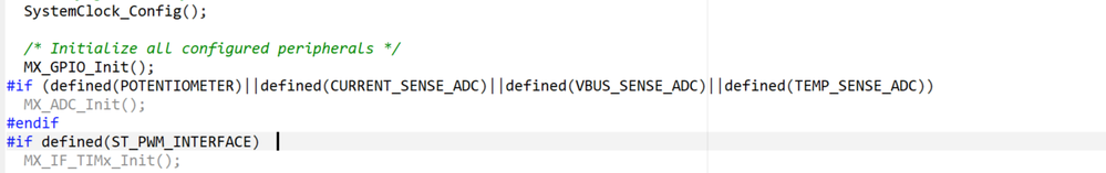

Hey Folks,
I'm unable to Enable this MX_ADC_Init() function can someone please help me it to do it.Below down i had attached the image for your reference can you please help me into it.
My aim is to control the speed of the motor by Potentiometer.
I'm using STEVAL-ESC002V1 solution of STM.

2025-11-18 8:15 PM
Hey i had tried it, but it is declared in most of the file in my project, i had declared it but after running it show some error as variable are not undefined. So i was looking a standard way to enable that section.

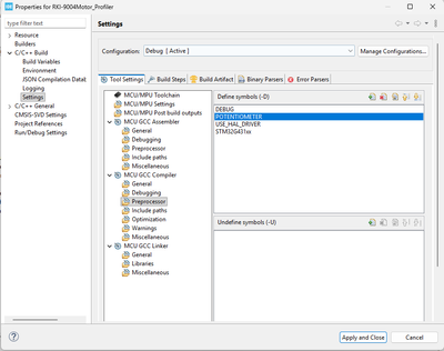

2025-11-18 10:04 PM
If you want at project level, please try below add the POTENTIOMETER in the compiler defines in the compiler settings and try.
