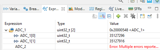

Thank you for the answer, The readings go from:
to only by adding HAL_ADC_Start(&hadc2);
the sample is triggered in the second event of a capture compare running at 20Khz, so I suppose the sample rate is 10Khz
Thanks in advance

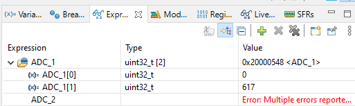

to
Thanks in advance
2022-02-04 8:37 AM
Changing DMA to Half Word and, consequently, the buffer data type to 16 bits did the trick. Still don't know why Thanks!
