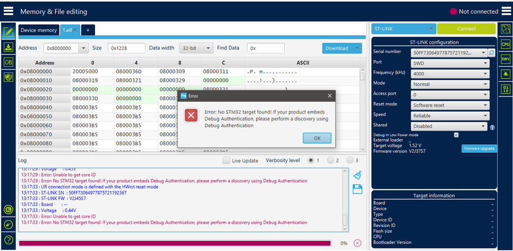

I am facing an issue while trying to connect to my STM32 MCU using STM32CubeProgrammer and ST-LINK V2.
Here are the details:
ST-LINK SN: 50FF73064977875712192367
ST-LINK Firmware Version: V2J45S7
Error Message:
Error: Unable to get core ID Error: No STM32 target found! If your product embeds Debug Authentication, please perform a discovery using Debug Authentication
Voltage Detected: ~0.48V
So there is no power on your target board!
You need to separately supply power - the ST-Link does not supply power.
Also, the board you're using appears to be a "Blue Pill" - this is not an ST product and will (almost) certainly not have a genuine STM-32 on it.

2025-04-28 12:53 AM
Thank you for your quick response!
Yes, I understand — and I have already tried supplying separate 3.3V power to the board.
Unfortunately, even with external power, the issue remains the same.
Regarding the point that this "Blue Pill" may not have a genuine STM32, I appreciate your clarification.
It seems that if the chip is not genuine, then there may not be any reliable way to recover or connect to it.
I will consider sourcing a verified genuine STM32 board for future projects.
Thanks again for your support!
