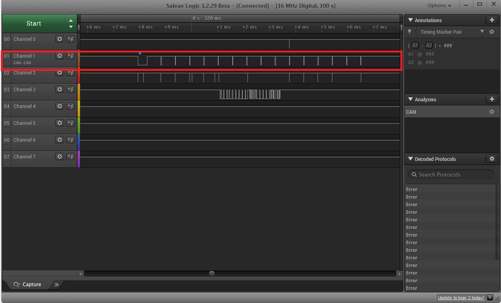

I am tried to send a simple message over CAN, but I got the broken Frame when transmitting, I capture it on a Logic Analyzer(Pic Below), it seems that it is Transmitting but not Correctly.
Did I did somting wrong or Did I miss Someting?And here is my Code:
