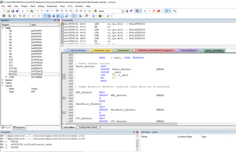

I know when we press the reset in keil or when reset happens the PC should start at 0x000...
ideally in my projects and flash is remapped to the start address.
But for me when I press reset it is going somwhere to 0x1ffff some stupid thing.
And I'm unable to debug. Can some one help me here?

Thank you for revisiting this information for me. But this is a old project and it is working one. Already in market and it contains one bootloader which jumps to application which is located at 0x0800 1000
Is it possible that the MCU is not powered properly and the boot pins are not in state, which is then switching to ROM upon startup?
