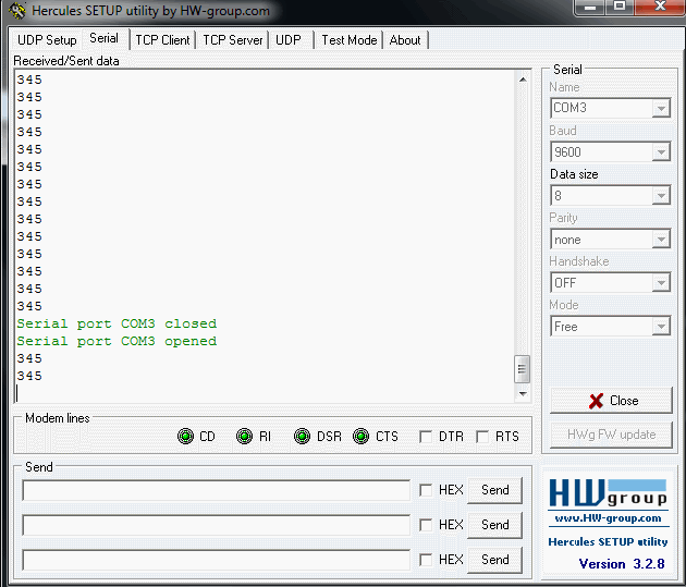

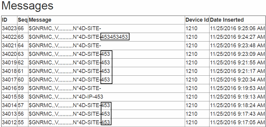

Hello all,
Directly, I want to talk about a problem I have encountered.I am working on 2 types of microcontroller and I use stm32f103 model to get data from the other one via rs4 So, For transmitting data from stm32f030 to stm32f103 , I am checking data transmition andif the correct data is being sent.In this part everything seems fine, the data is sent correctly. Then I am trying to get this data with stm32f103 microcontroller.In this part I use USART1 for communication via rs4 But unfortunately , during transmittion, stm32f103 does not indicate first character of the data and it continues untill the data transmission ends. So, Inthis case I don't want to miss this first character and I don't want to get this same data again and again in one go. Here is my receiving code of stm32f103(Expressions are available near codes)extern
''C''
void
USART1_IRQHandler(
void
if
(USART_GetITStatus(USART1, USART_IT_RXNE) != RESET)
//Data available in the Read Register.
//if(USART1->SR & USART_SR_RXNE)
// GPIO_SetBits(GPIOB,GPIO_Pin_0);
GPIO_WriteBit(GPIOB,GPIO_Pin_0, Bit_RESET);
//DE pin activation for receiving mode(rs485)
char
ch = rs485data.serialPort.getch();
//USART1 ''USART_ReceiveData(USART1);'' method
// if(ch!=50){
if
(ch!=10){
//if there is no new line in incoming data
if
(ch!=13){
//if there is no carriage return in incoming data
rs485data.serialPort.rxTrailerbuffer[rs485data.serialPort.rxTrailerbufferReadCounter++]=ch;
//fill buffer with character which comes from Usart1
if
(rs485data.rs485detect==
false
for
int
i = 0;i<rs485data.serialPort.rxTrailerbufferReadCounter;i++){
TrailerData[i]=rs485data.serialPort.rxTrailerbuffer[i];
//After we get the data from Usart1, we set data from trailerbuffer to TrailerData
rs485data.serialPort.rxTrailerbuffer[i]=0;
//clear Trailer buffer
TrailerData[rs485data.serialPort.rxTrailerbufferReadCounter]=0;
//clear Trailer Data
true
rs485data.serialPort.rxTrailerbufferReadCounter=0;
//clear Trailerbufferreadcounter
// if(rs485data.serialPort.rxTrailerbufferReadCounter>6){
// rs485data.serialPort.rxTrailerbufferReadCounter=0;}
//char ch = sp1.getch();
USART_ClearITPendingBit(USART1, USART_IT_RXNE);
//Clear pending bits for usart

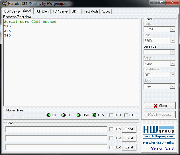

Here is , which data I want to send with stm32f030
2016-11-24 11:33 PM
Also I would like to share , how I send the data with stm32fIn this case, I used HAL drivers for some reason.
uint8_t buffer[100];
uint8_t *s;
int
len;
//void HAL_UART_RxCpltCallback(UART_HandleTypeDef *huart)
// if (huart->Instance == USART1) //current UART
// HAL_UART_Transmit_IT(&huart1, buffer, len);
// HAL_Delay(1500);
int
main(
void
HAL_Init();
SystemClock_Config();
MX_GPIO_Init();
MX_USART1_UART_Init();
//HAL_HalfDuplex_Init(&huart1);
//HAL_UART_IRQHandler(&huart1);
HAL_RS485Ex_Init(&huart1,1,0,100);
//HAL_UART_RxCpltCallback(&huart1);
//HAL_GPIO_WritePin(GPIOA,GPIO_PIN_1,GPIO_PIN_SET);
/* Infinite loop */
/* USER CODE BEGIN WHILE */
while
(1)
/* USER CODE END WHILE */
//printf(''HELLO
// HAL_Delay(500);
sprintf
(buffer,
''345
s=buffer;
len=
strlen
(buffer);
//len=sizeof(buffer) / sizeof(buffer[0]);
if
(__HAL_UART_GET_IT(&huart1, UART_IT_TXE)!= RESET){
//HAL_UART_Transmit_IT(&huart1, buffer, len);
//HAL_UART_Transmit_IT(&huart1,buffer,len);
HAL_UART_Transmit(&huart1,s,len,1000);
for
int
x=0;x<len;x++){
buffer[x]=0;
s=0;
len = 0;
//j++;
//if (j>len) j=0;
//UU_PutString(USART1,buffer);
HAL_Delay(35000);
/* USER CODE BEGIN 3 */
