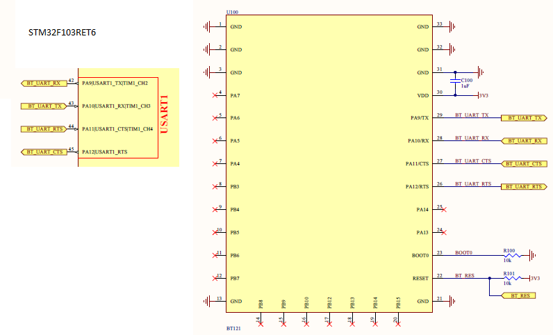

I've a problem on STM32F103RET6 microcontroller using the UART1 flow control in combination with the Bluegiga BT121 bluetooth chip. I'm using a custom board with these simple hardware configuration:

The problem is that
I can only send data but not receive
!I did several tests:
1. add pull-up resistors2. change the transmission speed3. try with a different hardware: ST Inemo + BT121 evaluation board but the only solution I found to be able to send messages was to disable the flow control.So, my question is: d
oes anyone have any idea why it does not work?
What am I doing wrong?
Many thanks in advance

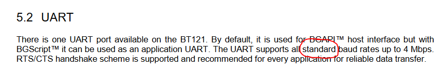

Hello!!
Your BAUD RATE is not correct. (
huart1
Init
BaudRate
460800
)(not default)

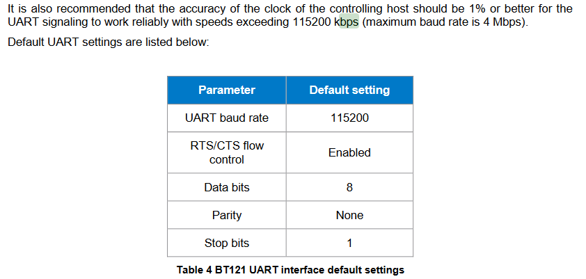

Hi Vangelis,
I also tried lower baud rates, for example 115200, 9600, without any positive result
2017-08-01 8:05 AM
Hello again.
Trannsmission speed must be 115200
all commands send to module must be consistent to BGAPI.
