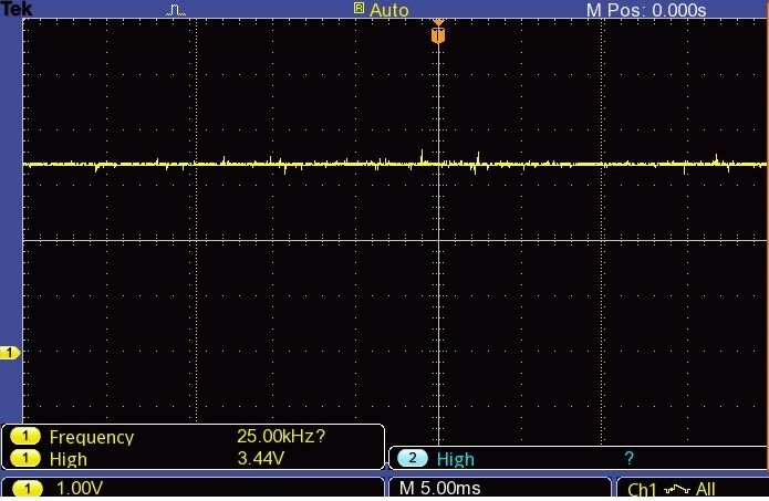

2015-09-13 9:53 PM
2015-09-13 10:23 PM

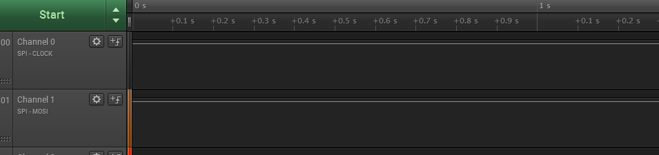

... and i have connected the lines to the logic analyser, and it looks so:
(I am sending the 0xAA byte in cycle)2015-09-15 2:36 AM
What version of std are you using?
Try those pins as output and just toggle them to see on the scoop if the hw is ok.2015-09-18 4:54 AM
