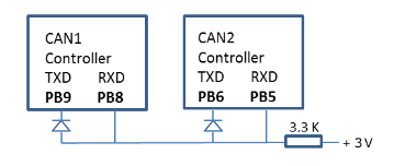

I connected the Tx output from one board to Rx of another, with 1N4148 diode. Could someone tell me where the problem is?

CAN_FILTERMODE_IDMASK not CAN_FILTERMODE_IDLISTYou'd need to connect the bus in a manner that a receiving device could acknowledge.2016-11-03 5:14 AM
Thank You for reply.
I changed the CAN_FILTERMODE_IDLIST for CAN_FILTERMODE_IDMASK and connected it by that scheme, but it still doesn't work.2016-11-03 9:36 AM
