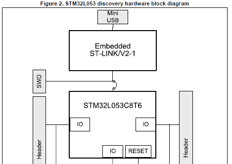

Your original question was specifically about the Discovery Kit.
If you look at the User Manual for the discovery kit, you will see a diagram like this:
The box marked ''Embedded ST-Link/V2-1'' is what provides the USB connection to your PC

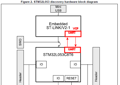

The diagram doesn't show it, but the Virtual COM port works like this:

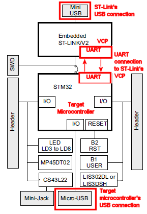

Perhaps this helps to distinguish the USB connection via the on-board ST-Link from the Target microcontroller's own USB connection:
See:
https://community.st.com/0D50X00009XkfBTSAZ
