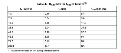

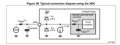

Looks like your signal is very high impedance. There will be some drop during ADC sampling as charges up the capacitance inside the ADC. This is normal, expected, and unavoidable for high impedance sources. Extending the sampling time until it reaches equilibrium is one way of mitigating this.
You can use an op-amp in follower mode to transform a high impedance signal to a low-impedance signal.
2023-06-28 11:02 AM
..or read ds . there input impedance on adc pin given - didnt read , eh ?
--otherwise you get , what you see: charging the adc input by your hi-impedance source !

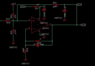

2023-07-05 4:12 AM
> I already tried with an opamp stage(LM2904).
Any schematics?
> But the result was the same.
What does it mean, exactly?
2023-07-11 9:29 PM
Hi waclawek.jan,
Please find the attached schematic
The same result meaning, the pulsating noise can still be seen on the ADC pin.
Thank you.
2023-07-11 11:02 PM
You should try a RRIO opamp such as the TS507 rather than the standard bipolar LM2904 whose output swing only reaches VDD-1.5V.
