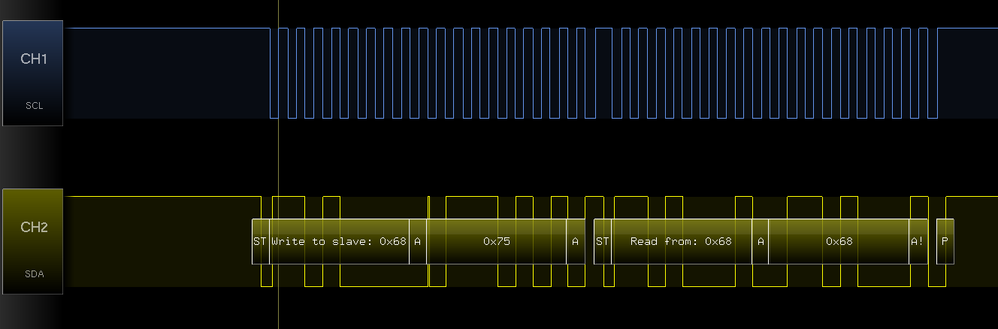

This is i2c transfer, and it looks quite good
