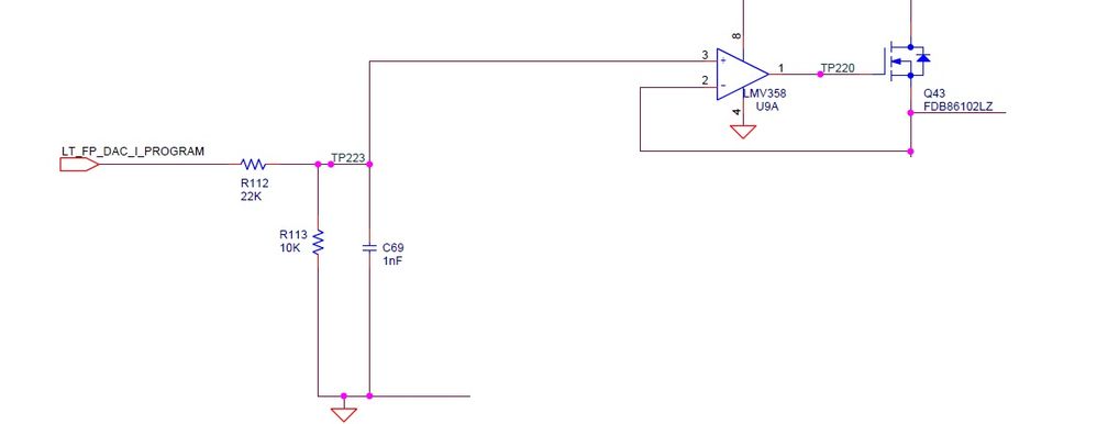

I´m having some difficulties getting the DAC working properly with the STM32F100 LQFP48pins.First of all, Reference Manual says the followingOn 64-pin packages and packages with less pinsThe VREF+ and VREF- pins are not available, they are internally connected to the ADCvoltage supply (VDDA) and ground (VSSA).I´ve in my PCB VDDA connected to 3,3v.11.3.5 DAC output voltageDigital inputs are converted to output voltages on a linear conversion between 0 and VREF+.The analog output voltages on each DAC channel pin are determined by the followingequation:DACoutput=VREF*DOR/4095Mi code is the following; GPIO_InitStruct.GPIO_Pin = GPIO_Pin_4; //GPIO_InitStruct.GPIO_Speed = GPIO_Speed_50MHz; GPIO_InitStruct.GPIO_Mode = GPIO_Mode_AIN; GPIO_Init(GPIOA_BASE, &GPIO_InitStruct); // DAC channel1 Configuration DAC_StructInit(&DAC_InitStruct); DAC_InitStruct.DAC_Trigger = DAC_Trigger_None; DAC_InitStruct.DAC_WaveGeneration = DAC_WaveGeneration_None; DAC_InitStruct.DAC_OutputBuffer = DAC_OutputBuffer_Disable; DAC_Init(xDACTable[DAC1].eDAC_Channel, &DAC_InitStruct);DAC_Cmd(DAC_Channel_1, ENABLE);DAC_SetChannel1Data(DAC_Align_12b_R, 0x0FFF);DAC_SoftwareTriggerCmd(DAC_Channel_1, ENABLE);Loading in DAC DOR register the Value =4095 I only get 2,5v instead of 3,3v Anyone knows why am I doing wrong?2014-10-27 11:27 AM

Correct. I'm repeating myself here, but sometimes when writing software, one needs to take the corresponding hardware into consideration.Take a look at the datasheet. The load resistance presented to the DAC output in your circuit is almost two orders of magnitude too small for unbuffered mode (1MOhm vs. 32kOhm, ignoring opamp input and C leakage).
