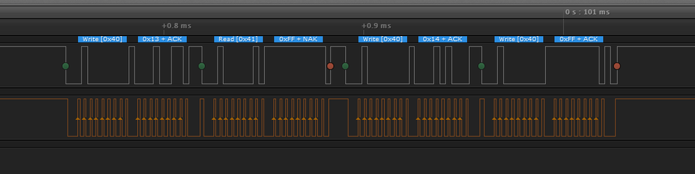

The program runs fine for hours. Bus activity is verified with a logic analyzer.
