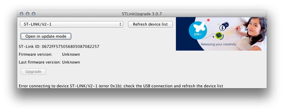

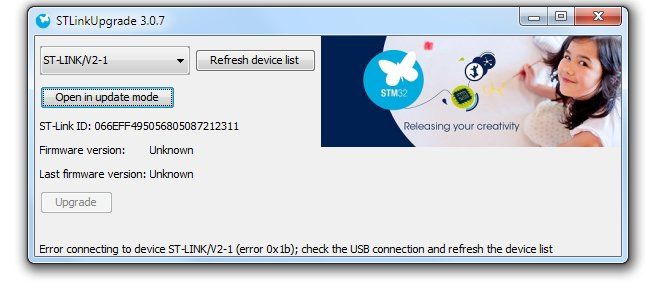

I can confirm the same issue and several people are reporting me the same problem. After updating the ST-LINK firmware to the latest 2.26.15, the ST-LINK interface nor longer works, and it's neither detected by the STLinkUpgrade.
This is the error message that appears:2016-02-25 10:23 PM
