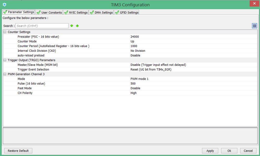

Today's F1 v1.6.1 HAL driver pack fixed all issues I had with GPIO so decided to move forward with TIM3 and LL.
The goal: use TIM3/PWM to blink the BLUE LED (PC8) - STM32VLDiscovery.
CubeMX generated code:

I added: ''LL_TIM_EnableCounter(TIM3);'' but the LED was still off. Started the debugger and noticed that the CCER register is cleared so I enabled CC3E manually and the LED started blinking.
Tried the ''LL_TIM_OC_ConfigOutput(TIM3, LL_TIM_CHANNEL_CH3, LL_TIM_OCPOLARITY_HIGH|xx);'' but failed.
Finally I fixed the issue using CCER register and it of course works.
TIM3->CCER=0x00000100; // Capture Compare Output Enable - channel3--------------------------------------

2018-03-19 2:51 PM
The library appears to do exactly what you commanded it to do:
TIM_OC_InitStruct.OCState = LL_TIM_OCSTATE_DISABLE;
thus, it did not enable that channel.
Or, use LL_TIM_CC_EnableChannel().
(Yes, I wouldn't touch Cube with a stick, LL or HAL. This was 5 minutes of browsing F4Cube sources; but I believe 'F1 will be the same).

Yes, I was looking for an option to enable the channel through CubeMX GUI but failed.
The 'TIM_OC_InitStruct.OCState = LL_TIM_OCSTATE_DISABLE;' was automatically generated by the CubeMX.
Needless to say that 'LL_TIM_CC_EnableChannel(TIM3, LL_TIM_CHANNEL_CH3);' solves the problem perfectly.
