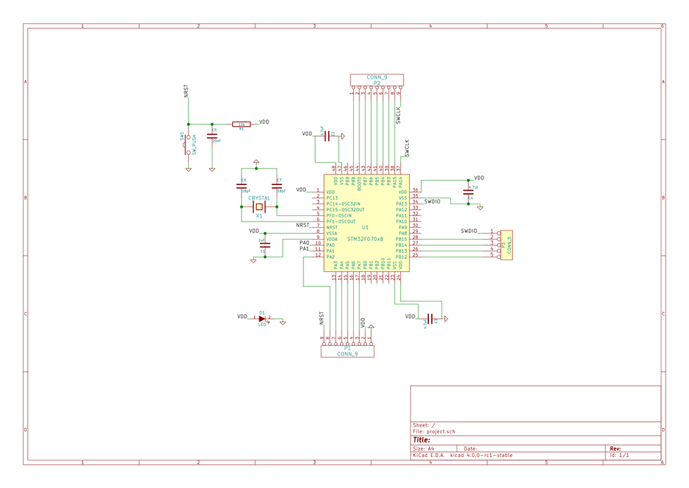

I designed the following circuit to interface an STM32F070 Micro for a project I'm working on.
I was hoping to get some feedback if I was doing everything the right way/will it work , before I order the PCB and BOM.2015-10-24 2:22 PM
I would probably place ALL the debug pins on a single header, ideally a standard one, but including SWDIO, SWCLK, NRST, GND, 3V3
Do something specific with BOOT0, have a pull down for normal operation, but with the ability to drive it high to get into the system loader. Consider adding an 32 KHz Oscillator, via PC14/PC152016-05-22 3:06 PM
This is a very old post, and I'm sure you have unfortunately found out the hard way that there is a problem with your circuit, but for future reference to anyone looking at this circuit, VDDA is incorrectly connected to GND and VSSA is incorrectly connected to VDD.
