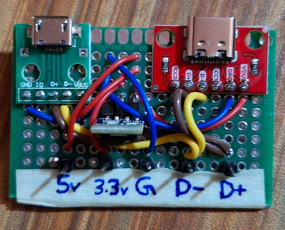

2026-01-23 5:42 AM - edited 2026-01-23 5:43 AM
Thanks for the clarifications so far — that helped me understand the board limitations much better.
I’ve now prepared a small USB interface board that supports both USB-C and Micro-USB, and it cleanly exposes the following signals:
5V (VBUS)
3.3V
GND
D−
D+
(see attached image)
My goal now is to connect this interface correctly to the NUCLEO-G491RE in order to use the ROM DFU bootloader of the STM32G491.
I would appreciate guidance on the following next steps:
1. Signal connection to the NUCLEO-G491RE
From what I understand so far, CN2 should not be used, and the USB pins of the STM32G491 are available on CN10.
Could you please confirm:
Which exact CN10 pins I should I connect to:
D+ → PA12
D− → PA11
GND → ?
VBUS (5V) or VBUS sense (if required) → ?
A small pin-to-pin confirmation would be very helpful.
2. Powering and VBUS detection
Should the STM32G491 be powered from:
ST-LINK USB (as usual), or
The 5V (VBUS) coming from my USB interface board?
Does the STM32G491 require VBUS to be present on a specific pin for the DFU bootloader to enumerate correctly?
3. Entering DFU mode
To activate DFU (system memory bootloader), is the following sequence correct?
Set BOOT0 = HIGH
Power-cycle or reset the board
Connect USB (D+/D−) to PA12 / PA11
Device should enumerate as STM32 DFU on the PC
Please let me know if:
Any additional jumpers are required
Any pins must be pulled up/down
Any common pitfalls exist when using an external USB connector like this
4. USB-C considerations
My USB-C breakout includes CC resistors and basic protection, but if there are minimum requirements (pull-downs, ESD, etc.) specifically needed for DFU reliability, I’d appreciate your advice.
Thanks again for your support and patience.
just want to be sure I’m connecting and booting the device correctly.
2026-01-23 6:12 AM
Hi again,
I have never tried such a setup,
but from what I read, I don't see immediatly anything wrong.
GND → any ground pin.
VBUS sense (if required) → VBUS sense not needed
Just for the "3. Entering DFU mode", the STM32G4 has some option bytes to select the boot mode. Either the boot selection (main flash or boot rom) is taken from the Boot0 pin, either it taken from the option bytes settings.
As far as I know on the MB1367, the option byte approach is chosen when the boards are manufactured, so setting JP7 might not help.
