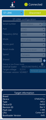

Connect st-link to board and try connect in CubeProgrammer, show what its telling.

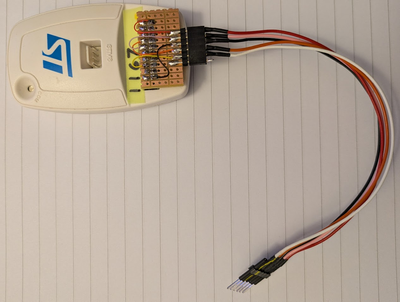

set software reset;
ex. with st-link V2 "stick" :

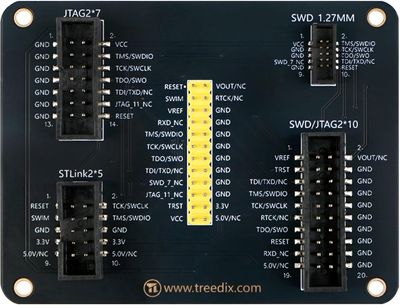

I understand tha a proper debug cable is preferable but I designed my board with a 6 pins header for debug and programming : Here is the breakout board

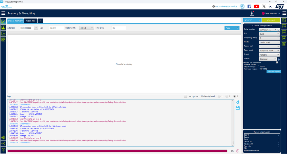

Here is a screeshot . I'm using CubeProgrammer V2.21.0

@Fabrice44 wrote:I understand that a proper debug cable is preferable but I designed my board with a 6 pins header for debug and programming
So you're connecting from the STLink to this breakout, and then from the breakout to your PCB?
Plenty of scope for errors & poor connections there!
Why not just go straight from the STLink to your board?
How do you connect the STLink to breakout?
Again, photos would help.
Why not just make a cable to connect direct from the STLink to your board; eg,

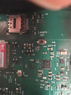

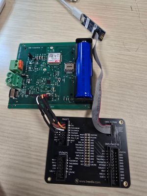

2026-01-13 5:04 AM
Here is some photos
2026-01-13 5:10 AM
Thanks.
Can you get a better closeup of the STM32?
