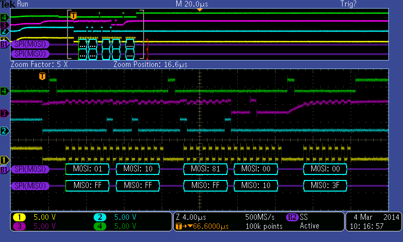

I have the SPI communication working but do not receive the answer of the slave. I can see the answer on the scope but not in the controller. Can anybody help ?My main.c/* Includes ------------------------------------------------------------------*/&sharpinclude ''main.h''void spiInit(void);void spiInit(){ SPI_InitTypeDef SPI_InitStructure; GPIO_InitTypeDef GPIO_InitStructure; RCC_AHBPeriphClockCmd(RCC_AHBPeriph_GPIOA | RCC_AHBPeriph_GPIOB ,ENABLE); RCC_APB2PeriphClockCmd (RCC_APB2Periph_SPI1, ENABLE); SPI_InitStructure.SPI_Direction = SPI_Direction_2Lines_FullDuplex; SPI_InitStructure.SPI_Mode = SPI_Mode_Master; SPI_InitStructure.SPI_DataSize = SPI_DataSize_8b; SPI_InitStructure.SPI_CPOL = SPI_CPOL_Low; SPI_InitStructure.SPI_CPHA = SPI_CPHA_1Edge; SPI_InitStructure.SPI_NSS = SPI_NSS_Soft; SPI_InitStructure.SPI_BaudRatePrescaler = SPI_BaudRatePrescaler_32; SPI_InitStructure.SPI_FirstBit = SPI_FirstBit_MSB; SPI_InitStructure.SPI_CRCPolynomial = 7; ///////////////////////////////////////////////////////////////////////////// // SPI1 Master initialization, SCK -> PA5, MOSI -> PA7 GPIO_StructInit (&GPIO_InitStructure); GPIO_InitStructure.GPIO_Pin = GPIO_Pin_5 | GPIO_Pin_7; GPIO_InitStructure.GPIO_Mode = GPIO_Mode_AF; GPIO_InitStructure.GPIO_Speed = GPIO_Speed_50MHz; GPIO_InitStructure.GPIO_OType = GPIO_OType_PP; GPIO_InitStructure.GPIO_PuPd = GPIO_PuPd_UP ; GPIO_Init(GPIOA, &GPIO_InitStructure); GPIO_PinAFConfig(GPIOA, GPIO_PinSource5, GPIO_AF_0); GPIO_PinAFConfig(GPIOA, GPIO_PinSource7, GPIO_AF_0); // MISO -> PA6 GPIO_StructInit (&GPIO_InitStructure); GPIO_InitStructure.GPIO_Pin = GPIO_Pin_6; GPIO_InitStructure.GPIO_Mode = GPIO_Mode_IN; GPIO_InitStructure.GPIO_Speed = GPIO_Speed_50MHz; GPIO_InitStructure.GPIO_PuPd = GPIO_PuPd_UP; GPIO_Init(GPIOA, &GPIO_InitStructure); GPIO_PinAFConfig(GPIOA, GPIO_PinSource6, GPIO_AF_0); // CS or SS chip select -> PA4 GPIO_StructInit (&GPIO_InitStructure); GPIO_InitStructure.GPIO_Pin = GPIO_Pin_4; GPIO_InitStructure.GPIO_Mode = GPIO_Mode_OUT; GPIO_InitStructure.GPIO_Speed = GPIO_Speed_50MHz; GPIO_InitStructure.GPIO_OType = GPIO_OType_PP; GPIO_InitStructure.GPIO_PuPd = GPIO_PuPd_UP ; GPIO_Init(GPIOA, &GPIO_InitStructure); // SPI1 SPI_Init(SPI1, &SPI_InitStructure); SPI_RxFIFOThresholdConfig(SPI1, SPI_RxFIFOThreshold_QF); SPI_Cmd(SPI1, ENABLE); }void ChipSelectLow(){ GPIO_WriteBit(GPIOA, GPIO_Pin_4, Bit_RESET);}void ChipSelectHigh (){ GPIO_WriteBit(GPIOA, GPIO_Pin_4, Bit_SET);}uint8_t SPI1_send(uint8_t data){ SPI1->DR = data; // write data to be transmitted to the SPI data register while( !(SPI1->SR & SPI_I2S_FLAG_TXE) ); // wait until transmit complete while( !(SPI1->SR & SPI_I2S_FLAG_RXNE) ); // wait until receive complete while( SPI1->SR & SPI_I2S_FLAG_BSY ); // wait until SPI is not busy anymore return SPI1->DR; // return received data from SPI data register}int main(){ uint8_t received_val = 0; spiInit(); ChipSelectHigh (); //********************************* ChipSelectLow (); SPI_SendData8(SPI1 , 0x01); SPI_SendData8(SPI1 , 0x10); while( !(SPI1->SR & SPI_I2S_FLAG_TXE) ); // wait until transmit complete while( !(SPI1->SR & SPI_I2S_FLAG_RXNE) ); // wait until receive complete while( SPI1->SR & SPI_I2S_FLAG_BSY ); // wait until SPI is not busy anymore ChipSelectHigh (); //********************************* ChipSelectLow (); received_val = SPI1_send (0x81); ChipSelectHigh (); ChipSelectLow (); SPI_SendData8(SPI1 , received_val); // test um auf der SPI zu sehen, ob etwas angekommen ist while( !(SPI1->SR & SPI_I2S_FLAG_TXE) ); // wait until transmit complete while( !(SPI1->SR & SPI_I2S_FLAG_RXNE) ); // wait until receive complete while( SPI1->SR & SPI_I2S_FLAG_BSY ); // wait until SPI is not busy anymore ChipSelectHigh (); while (1) { } }2014-03-04 5:27 AM

Finally found it myself! :)
one thing is that MISO has to be configured GPIO_Mode_AF and not GPIO_Mode_IN:// MISO -> PA6 GPIO_StructInit (&GPIO_InitStructure); GPIO_InitStructure.GPIO_Pin = GPIO_Pin_6; GPIO_InitStructure.GPIO_Mode = GPIO_Mode_IN; GPIO_InitStructure.GPIO_Speed = GPIO_Speed_50MHz; GPIO_InitStructure.GPIO_PuPd = GPIO_PuPd_UP; GPIO_Init(GPIOA, &GPIO_InitStructure); GPIO_PinAFConfig(GPIOA, GPIO_PinSource6, GPIO_AF_0);the main now looks like:uint8_t Send( uint8_t data){ SPI_SendData8(SPI1, data); while( SPI1->SR & SPI_I2S_FLAG_BSY ); // wait until SPI is not busy anymore return SPI_ReceiveData8(SPI1);}int main(){ uint8_t received_val[4]; spiInit(); //********************************* ChipSelectLow (); received_val[0]=Send(0x01); received_val[1]=Send(0x10); ChipSelectHigh (); //********************************* //********************************* ChipSelectLow (); received_val[2]=Send(0x81); received_val[3]=Send(0x00); ChipSelectHigh (); //********************************* ChipSelectLow (); SPI_SendData8(SPI1 , received_val[3]); // test um auf der SPI zu sehen, ob etwas angekommen ist while( SPI1->SR & SPI_I2S_FLAG_BSY ); // wait until SPI is not busy anymore ChipSelectHigh (); while (1) { } }I hope it helps if anybody ist searching for a long time like me.I always read that somebody found the problem but never the code was published.2014-03-04 7:22 AM
