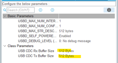

Looks like the CDC is using a lot of RAM. If you change the buffer from 1024 to 512, then it will fit.

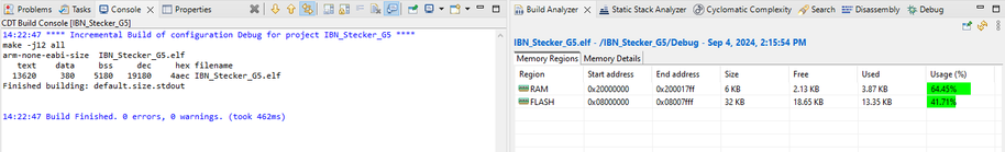

What optimisation setting are you using?

@Andrew Neil : What optimisation setting are you using?
I did not change anything in the default settings, but I will have a look on it. Thank you!

I changed the size of some buffers, but I doesnt work.

Then likely it's NO optimisation - so definitely start by adjusting that!
And a big +1 to @Karl Yamashita's suggestion to start developing on a bigger device - it's far easier to find optimisations in something that does build than in something that doesn't.
When it does build, you will have a map file to look at to see where all the code space is going.

the optimization settings and lowering the buffer size does work, thanks for your help!
