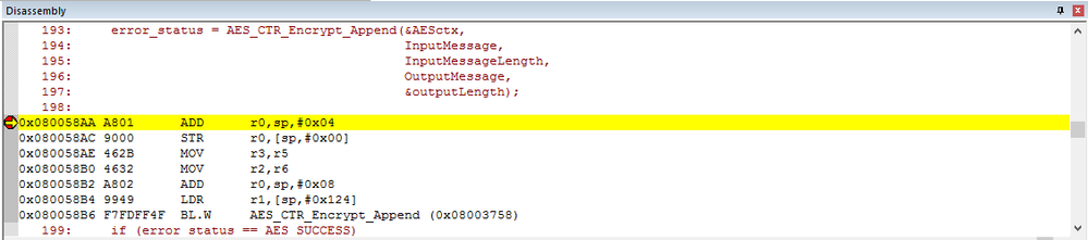

2018-01-07 1:40 AM
Here is screenshot of Dis
assembly
. Hard fault is coming after execution of add instruction.2018-01-07 7:13 AM
and the CPU registers...'
You need to review the code within the context it is executing. Is the stack pointer properly aligned? Is the stack deep enough?
