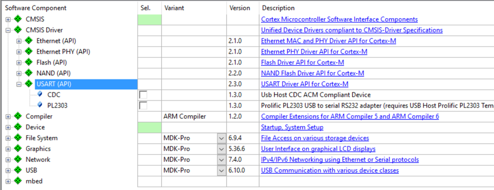

first i look here
but there is no usart driver.

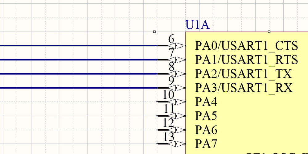

this is my schematic
according to schematic i use pa2 and pa3 as usart.
please tell me if there is any library to init usart and use it.
