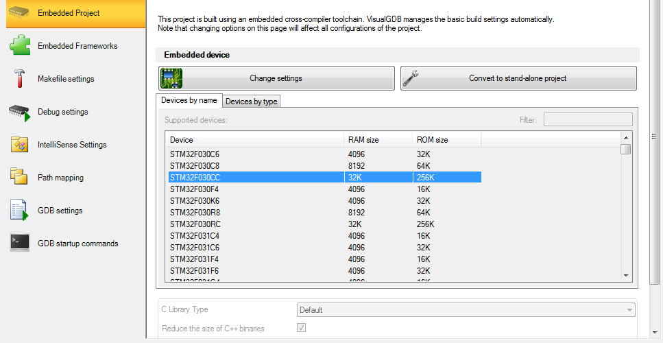

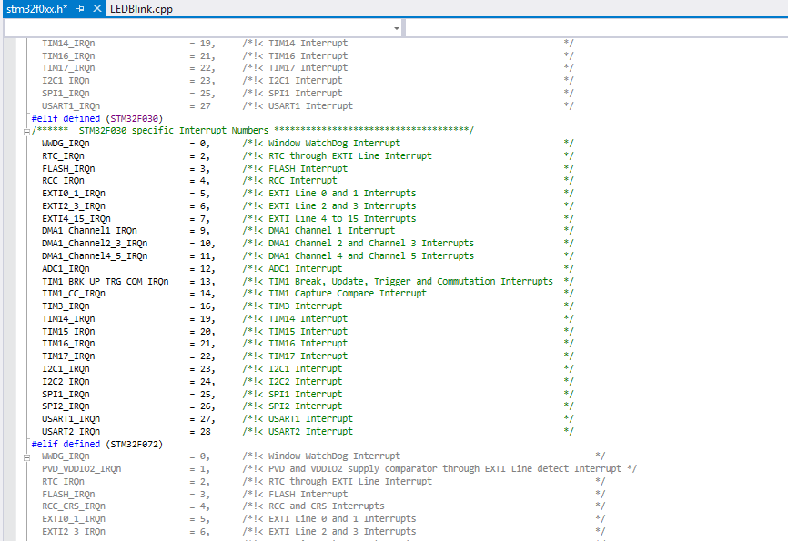

I am trying to configure UART interrupts, but I can't seem to find where/how to define which MCU am I using. When I made the project I chose the STM32F030CC which I am using, but in stm32f0xx.h file it seems like STM32f030 is selected. I will add some screenshots so it is easier to understand./* Uncomment the line below according to the target STM32F0 device used in your

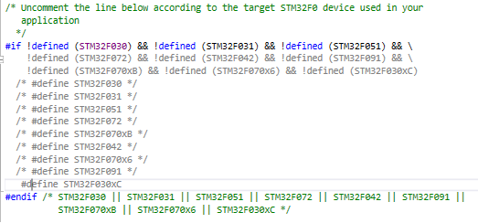

I deleted /* */ in the #define STM32f030xC but it is still in gray color, and does not let me to compile.

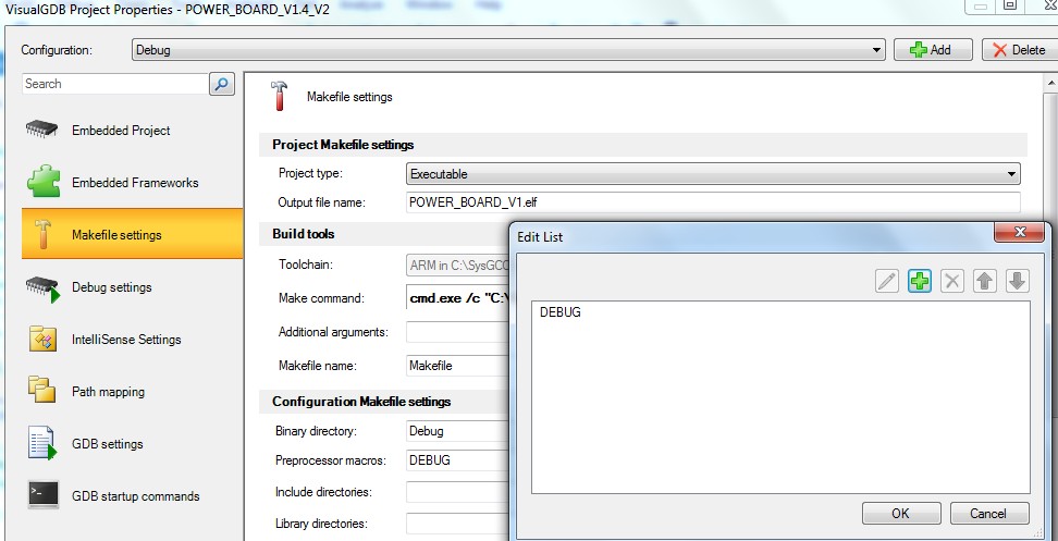

Check the preprocessor values defined for your project. STM32F030 should be defined there (check the options of your project depending on the used IDE).-Mayla-To give better visibility on the answered topics, please click on Accept as Solution on the reply which solved your issue or answered your question.
2016-03-17 2:05 AM
I checked the preprocessor macros and there is only DEBUG.

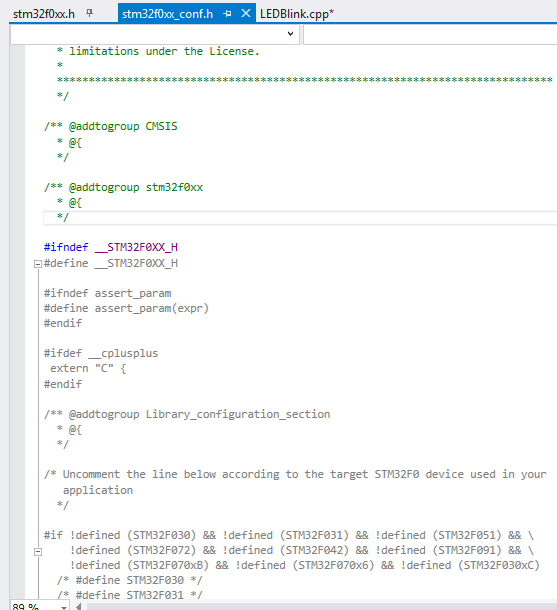

I used the preprocessor macros which you advised and copied a stm32f0xx_conf.h in project directory and it gets included in stm32f0xx.h when there is USE_STDPERIPH_DRIVER preprocessor macro, but there is another problem.When I open the stm32f0xx_conf.h it looks like this:We’re moving the ST Community to a new platform to give you a better and more reliable community experience.
