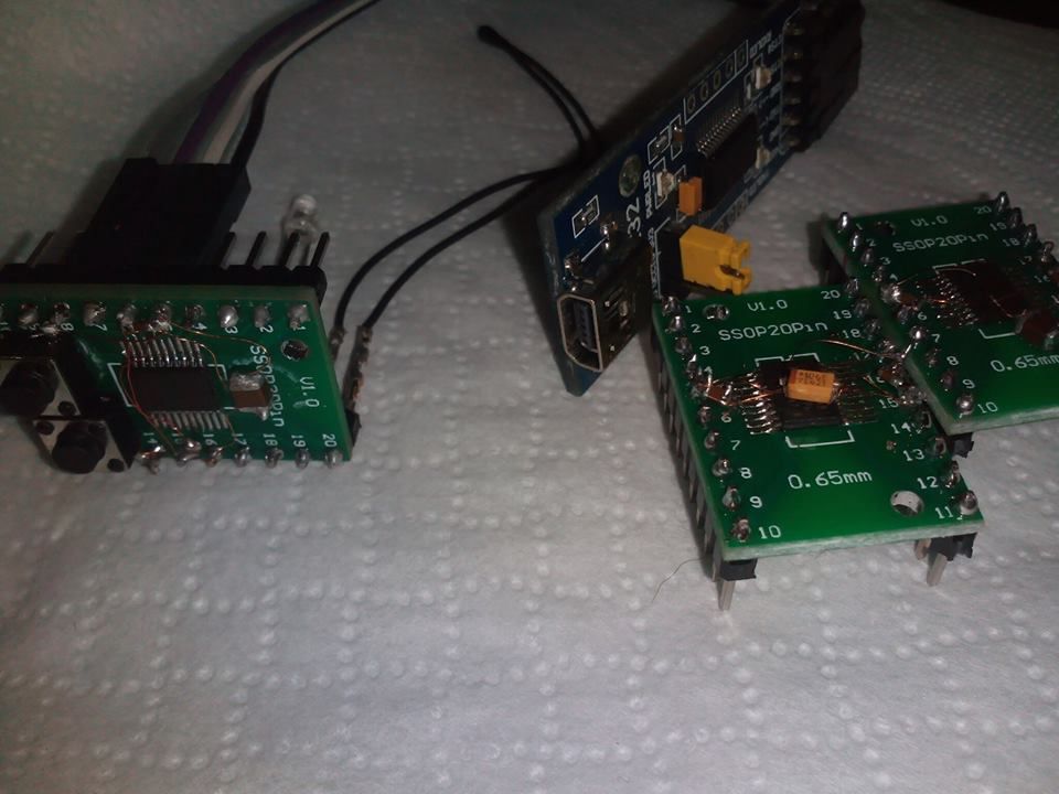

I hope you can help solving a mystery. I stumbled upon these cute stm32f030f4 µCs and built minimalistic boards with it. No external oscillator used, thus pins PF0 and PF1 should be useable as GPIOs. I tried several things already. Current state is explicitly disabling HSE, deinit the clock system and setting it up correctly:// ---- Setup PLL for 48 MHz :) ----

It doesn't make a difference whether the HSE-Disable is before or after deinit. I also modified CMSIS/stm32f0xx.c -> SysCLKinit so HSE was disabled by all means, but that didn't help either.

I'm running out of ideas what else to do to get all 15 GPIOs working. Maybe someone already managed that and has a pointer to the solution.

Problem solved: I need to go back to the soldering station.
Just replaced the board with another one I built and it immediatly works, even without calling the ''RCC_HSECmd''; RCC_DeInit() suffices.Great, now I can use 15 IOs! :)We’re moving the ST Community to a new platform to give you a better and more reliable community experience.
