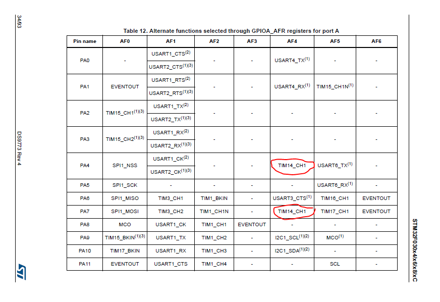

Some suggestions for the GPIO:
I have my reason for not divulging into CubeMX, so my experience with it is close to zero.
But the F030 is a quite mature design, and the SPL + SPL-based discovery firmware still around. I suppose you can find some code examples there as well.
2019-04-23 5:30 AM
I didn't get you ??
I have have used PA4 (TIM_CHANNEL_1)
