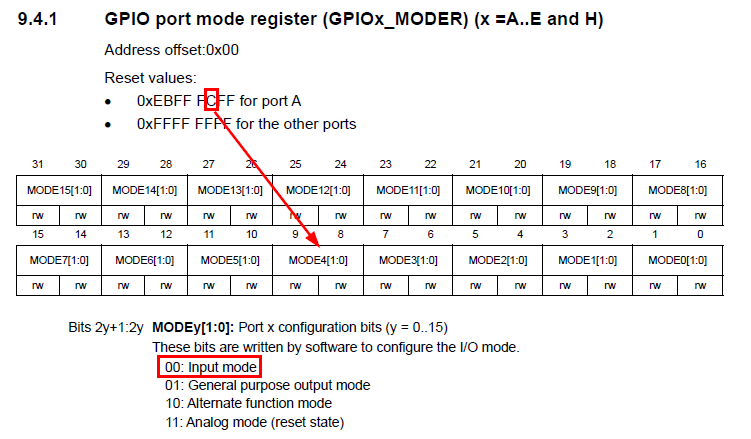

On the STM32L072 series, the reset state of all the pins are "Analog mode", except for PA4, PA13 (SWDIO) and PA14 (SWCLK).
When I put the STM32 into STOP mode, PA4 (configured as an input) causes the current consumption to increase by ~10uA. When I configure it as analog, the current consumption goes down to an acceptable 1.7uA (with 32 kHz crystal running).
I would like to know why PA4 is configured as an input after reset. One of it's alternative functions are "DAC_OUT1"... could this be the reason?

Hi @Pieter Conradie ,
In the footnote of the pinout table, we mention that PA4 is a "spacial" pin:
"PA4 offers a reduced touch sensing sensitivity. It is thus recommended to use it as sampling capacitor I/O."
That is why it has this reset value in GPIOA_MODER register.
-Amel
