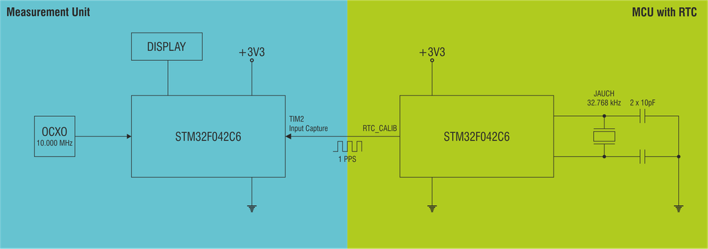

This is my measurement mechanism:

The measurement unit can be count 10M for every second and 32 x 10000000 = 320000000 for 32 seconds period.

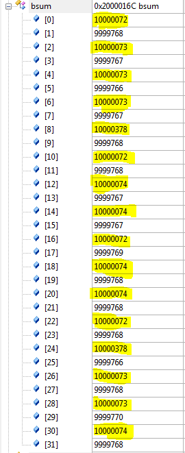

The following table shows masked measurements marked in yellow. Here it is seen that 14 x 1 clock + 2 x 2 clock = 18 clock masked. But 24 clock should have been masked.

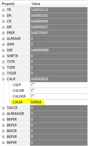

I observe that the CALM value is written correctly:

This is very irregular to be true.
Is your measuring unit measuring *consecutive* seconds, i.e. taking the 32 measurements from table in first post were measured lasted exactly 32 seconds?

All of the CALM values are written correctly to the CALR register. The CALP (+488,5 ppm offset) is works correct, but CALM doesn't.
2019-03-28 7:20 AM
I solved the problem with your advice. The results were read by skipping one, not consecutive. I fixed my input capture code and its works correctly.
