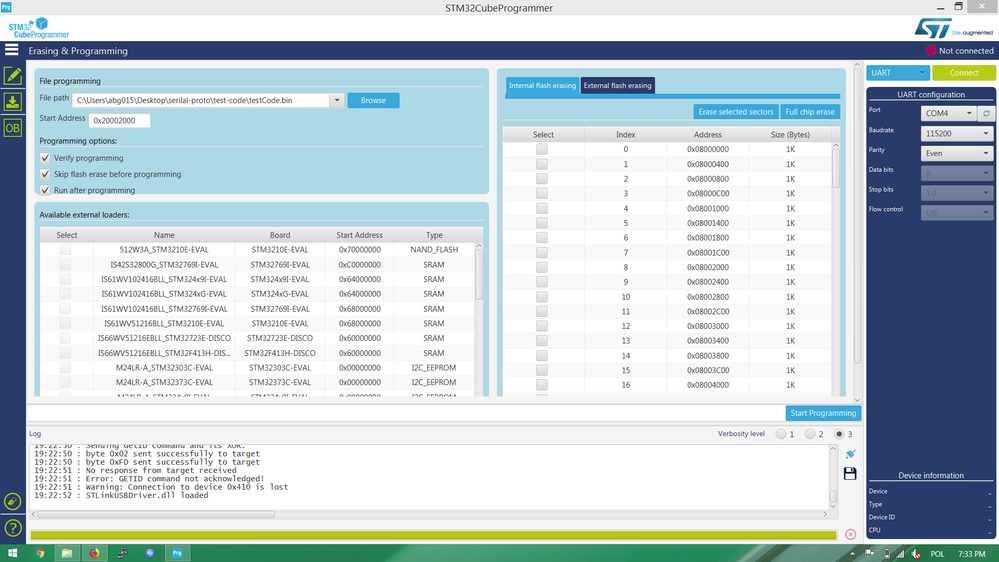

Once you remove a folder you used lately the STM32CubeProgrammer cannot open a file and consequently program the MCU.
How to reproduce:
1. Select 'Erasing & Programming' window, open a file (either hex or bin) and program the MCU (I tested RAM programming through UART but ST-Link mode seems to be also affected)
The file 'testCode.bin' was located here:
C:\Users\abg015\Desktop\serilal-proto\test-code\
2. Remove/Rename (this is crucial) the folder where the file is located, e.g.
rename the folder:
to:
C:\Users\abg015\Desktop\serilal-proto\test-code2\
3. Since then you cannot navigate to any folder using 'Browse' button, The 'Browser' button do es NOT react to mouse clicking. So you cannot open any file, neither program the MCU since then.
4. Once you restore the folder (previously removed/renamed) you can open any new file.
2018-04-09 10:47 AM
Leaving the STM32CubeProgrammer and starting it again does NOT fix the issue. You need to restore the removed/renamed folder.

2018-04-12 2:15 AM
This is beginer programmer error.
You can fix this by deleting config.properties file.
In Ubuntu, file is located at: /home/<USER>/.STM32CubeProgrammer
