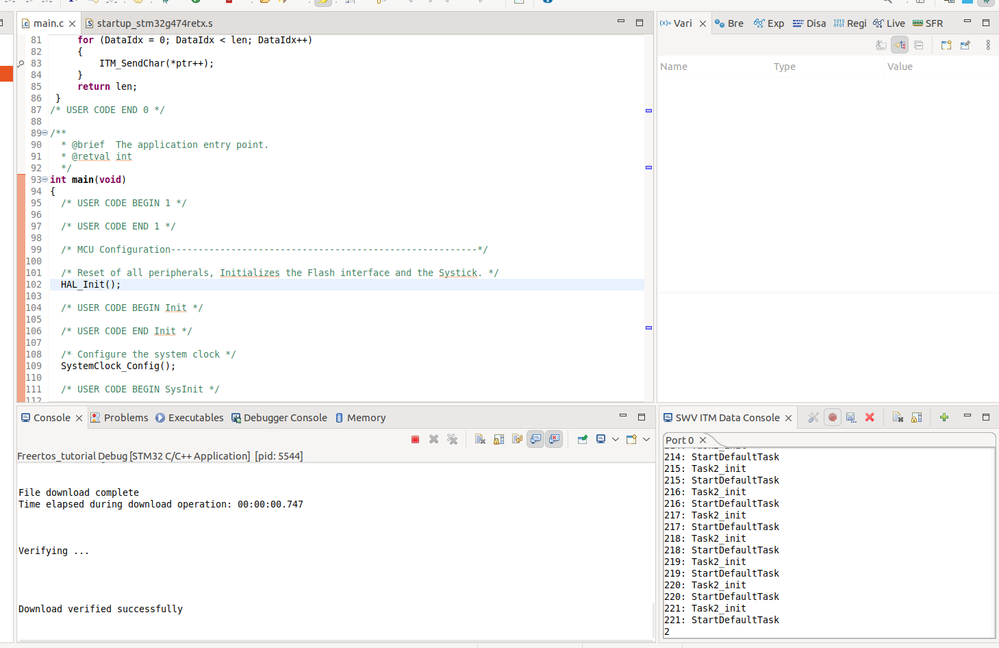

I am using a SWV ITM to print the messages but it always stoped printing after 221 counter number as below image. Could any tell us what needs to be set to see continues printing.

Is it crashing, or Hard Faulting ?
If you stop in the debugger, where does it stop? In the for loop in _write() ?
Using ST-LINK?Which version, which firmware?
Do you see the same behaviour if you use the SWV function of STM32 Cube Programmer ?

Ah no, it is not crash or hard fault.
When i debug, It does go inside the _write() function but never print out.
