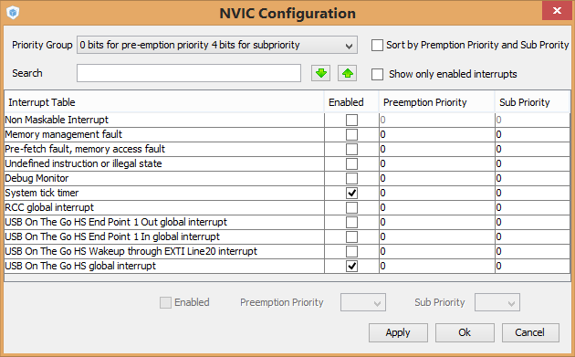

2014-06-25 9:51 AM
HAL_Init();
SystemClock_Config();
/* System interrupt init*/
/* Sets the priority grouping field */
HAL_NVIC_SetPriorityGrouping(NVIC_PRIORITYGROUP_0);
HAL_NVIC_SetPriority(SysTick_IRQn, 0, 0);
MX_GPIO_Init();
MX_SDIO_SD_Init();
MX_USB_HOST_Init();
SystemClock_Config(); will configure you clock and then HAL_NVIC functions setup your interrupt for SysTick_IRQn. Then when the systick interrupt fires your interrupt handler (SysTick_Handler()) should be called, which increases the uwTick variable ( fires every 1ms ).
If using MXCube ensure System tick timer interrupt is enabled.
