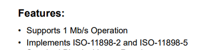

1- MCP2561 is OK. But please select the version having VIO pin. But becarefull this transceiver could not exceed 1Mb/s if you are planning to use CAN-FD data rate > 1Mb/s:
If you plan to exceed that bitrate, I may suggest MCP2562FD that can reach up to 8Mb/s.

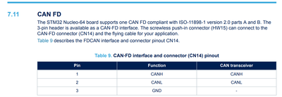

2- For the schematic and cad resources for NUCLEO-C092RC board, they are not yet available on the ST website.
It will be available soon. For the moment, you can rely on the UM3353

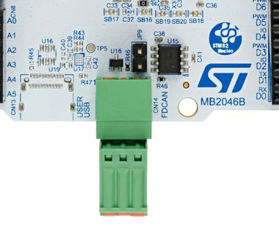

Edit: NUCLEO-C092RC has already a CAN-FD transceiver:
No need to add another CAN transceiver.
And this is the CAN connector (in green) correspond to CAN_H and CAN_L + GND (I think):
Hope that answers your questions.
