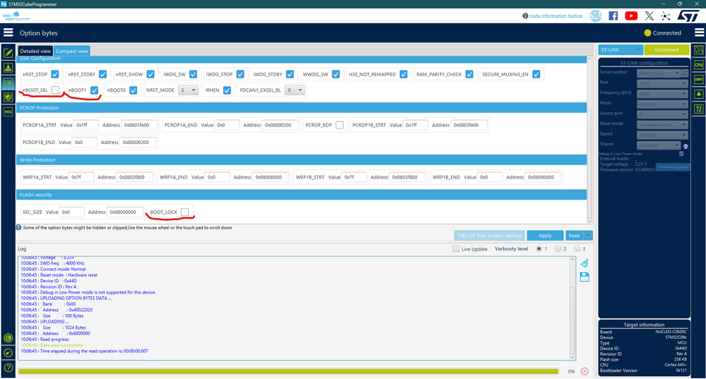

I would like to test UART Bootloader on my NUCLEO-C092RC.
System Bootloader mode can be selected pressing the BOOT (B3) pushbutton while resetting the STM32C092 mcu through RESET (B2) pushbutton and without the ST-Link interference removing JP2, JP4, JP6, JP7 jumpers, right?
UART2 on PA2 (TX) and PA3 (RX) port-pins is one of the UARTs handled by System Bootloader, right?
UART2 is already connected as Virtual Com Port (VCP), so it can be used with bootloader through CN1 USB-C connector, right?
Furthermore, BOOT0 pin must be enabled for boot mode selection in the User Option Bytes, right?
Now, my STM32C092 mcu has nBOOT_SEL bit just cleared in Opton Byte and my simple led blinking application is running. If I keep BOOT pressed while I press and release RESET, my led blinking app still start running and STM32CubeProgrammer does not connect with the target.
Is my procedure correct? How to start NUCLEO-C092RC in System Bootloader through BOOT pushbutton?
And UART2 as VCP is available to test System Bootloader through UART?

With STM32CubeProgrammer through ST-Link I verified:
So, why System Bootloader does not start when I reset the NUCLEO with BOOT pushbutton pressed?
