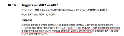

According to the documentation there is that statement:
But still to confirm if "A/C" means ADC. I will check internally and get back to you as soon as I have an answer.

Indeed A/C stands for ADC.
