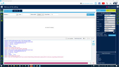

Regarding stm32cubeprog v2.18.0, the connection could not established.
For Keil 5.41, even though I selected the correct part of STM32C071CB, the 128K flash part, Keil just give me the flashing driver of STM32C0x_64, which is not the appropriate driver to being used for the 128K part. I did look into the corresponding file folder, and I did locate STM32C0x_128.FLM file but some how I cannot get this in the file list for the selection.

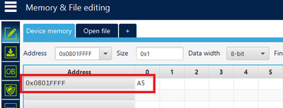

Hello @Chan.Calvin ,
For CubeProgrammer I didn't reproduce the behavior with a NUCLEO-C71RB. C71RB and C71CB are same from Flash point of view. So you need to check your HW.
This is a screen shot of my connection with CubeProgrammer to an STM32C71RB. I've written 0xA5 to the last location of 128KB:

2024-12-04 1:18 AM
Hi all
Attached is the cubeprog and stlink screenshot for your ref.
I believed it is the genuine stlink v2. And we are using custom board.
As mentioned before, with the C071CB on custom board, it is failed to flash.
Replacing the C071CB with C031C6, the board becomes alive, and I can do flashing and Keil debugging.
Another blank PCB, with just only another new C071CB put on, that also failed to flash.
That points to me that it is either the batch of faulty MCU, or missing update driver to handle xB - 128K parts.
