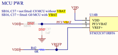

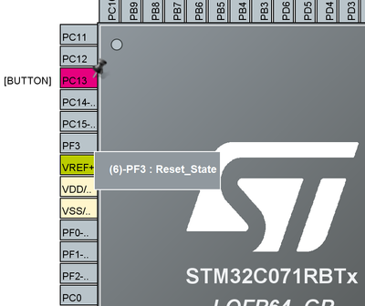

> 1) In the 64-pin version, pin 6 is the VBAT to connect a battery or a supercapacitor to maintain the RTC operation in case of power loss. Where has it gone in the 32-pin version?
VBAT isn't on either chip. Pin 6 is PF3. Where are you seeing that it's VBAT?
2025-01-28 2:54 AM
You are right! My mistake, sorry.
The schematic of NUCLEO-C071 misled me as it lists pin PF3/VBAT (see attached image). I hadn't read the note that says 'fitted: G0 MCU with VBAT'. So using C071, VBAT is never present.

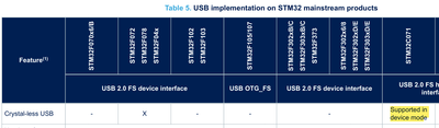

Great. Your other question is answered by @Chris21 above. 32-pin can't use a crystal as there is no OSC_OUT pin. The chip does support Crystal-less USB as a device.
