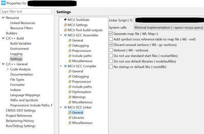

Hi all.
Upgrading the STM32CubeProgrammer to v2.17 we found that the issue was related to the size of the ExternalLoader.
We fixed it in this way:
2025-02-06 4:17 AM
Can you show a template of this modified linker?
