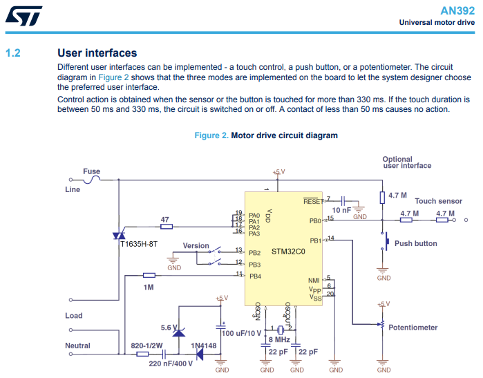

I am a little confused here, AN392 claims to run STM32C0 from a 5V power supply, directly from the main fed RCD dropper with a 5.6V Zener. But the datasheet says the maximum voltage is 4V.
So does the AN suggest running way over max specs or is there something I miss?

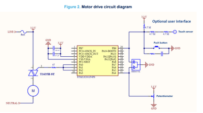

Issue fixed in AN392 Rev 4 / figure 2.

You mean this?
2024-04-11 4:45 AM - edited 2024-04-11 4:45 AM
Internal ticket 178788 has been created to fix this. The ticket is not accessible by the community users.
