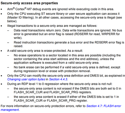

Hello @sschneider,
Are you enabling the secure access mode? Is SECURITY bit in FLASH_OPTSR_CUR register set to1?
May be RM0468 section can help you to find the issue.
