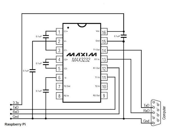

Hi Ivan,
Well, with that description I'm agree with your friends, the pins could be damage. When you use a RS232 converter, you don't have to plug the microcontrollers pins directly for what your friends said, voltages levels. The right way to connect the micro with the usb-RS232 converter is using a MAX3232 as show the following image:

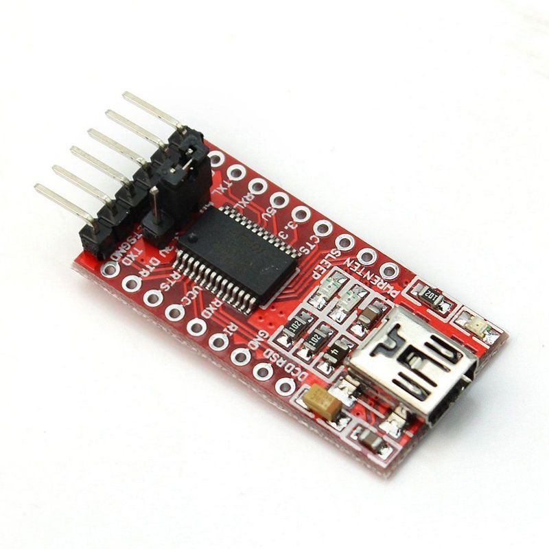

Well, when say Raspberry goes your microcontroller or board. I prefer don't use those kind of converters, instead I use a USB-to-Serial converter like this one:
The outputs levels are configurables to 5V or 3.3V with the jumper and you can connect directly to your micro. I suggest to you to make the rigth connections with the MAX3232 if you are still using the RS232 converter or try to acquire the serial converter and make a test with other USART.
2017-05-16 11:07 AM
As Elkin points out, there are USB-to-CMOS Serial converters, these are actually more prevalent the ones that also include the RS232 level converters, as most MCU and GPS type modules natively interface at CMOS levels, and RS232 is really just for external connectivity to other systems.
I would generally recommend the use of SiLabs parts, there are a lot of fake FTDI parts in the channel, and FTDI as a company has released broken and damaging drivers. I also see Prolific drivers Blue Screen my systems.
SiLabs CP2120 boards are readily available on eBay and Amazon platforms for under $4 shipped.
