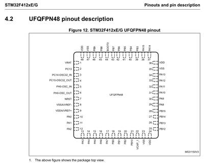

I'm using STM32F412CG chip in UFQFPN48 package. This chip version doesn't even have the MCO2 pin (PC9).

It's all default values for PC9, since my package doesn't even have the PC9 pin.
