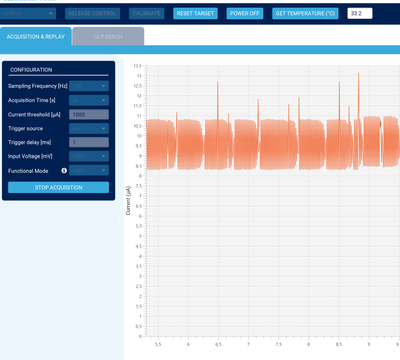

However, when I measure it with my STLINK Power Monitor, I get about ~10 µA with fast oscillations.

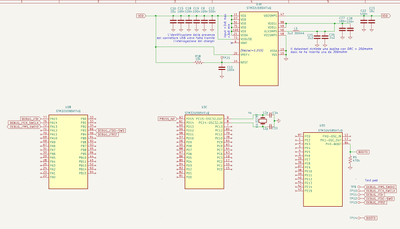

2025-10-14 3:05 AM
Thank you for your quick reply.
No, I haven’t been able to test any examples on an ST board yet, but I used the official examples as a reference.
This is my current hardware setup. The board is actually more complex, but at the moment the only components populated are the ones shown in the photo — all other pins are floating.
