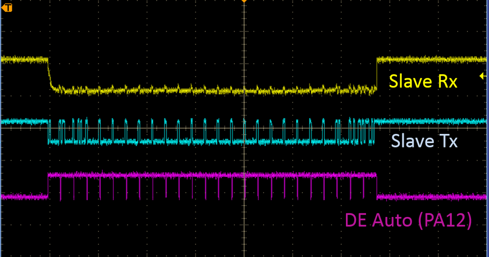

I suppose DE pin waveform should be matched to Slave_Tx ( X wrong)
-> The DE pin waveform should be driven to high until Tx send out data.
The DE pin is likely a periodic pulses. (That was strange)

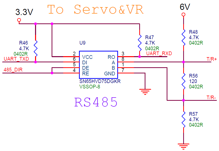

My Schematic is as follow (485_DIR = DE)

What do you mean by "match" in "DE pin waveform is not matching to salve_Tx waveform"? DE should be active during the whole duration of transmitted frames (transmitted bytes), and it appears to be so. It of course cannot be identical to Tx.
2018-12-12 11:12 PM
@JW Yes, you are right ( DE should be active during the whole duration of transmitted frames), even though, my DE still wrong.
2018-12-13 1:28 AM
I finally got the reason, cause I am using freeModbus lib, it will turn off interrupt when Rx or Tx done.
That will cause this phenomenon.
